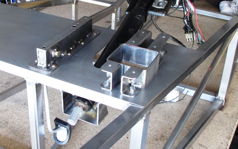

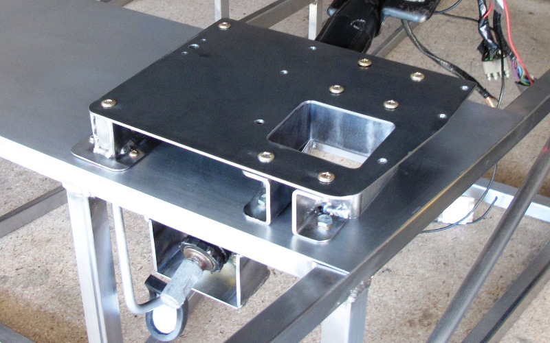

Well this only took way too long. Determined to use as many pieces from the M.G. donor as possible, I crammed the original pedal box and steering column into the same space on the engine bay shelf by building a ridiculously complex assembly of boxes, brackets, and sheet metal that all bolts together in under four hours.
I built a seperate gas pedal box and used that as part of the support for the brake and clutch pedal box. I could've welded everything together, but then the steering wheel would've been trapped, so the only thing welded in place is the mount for the steering column. The good news is, the steering wheel is just about exactly centered and the pedals mostly all move back and forth without hitting anything.
I assembled everything for these photographs, then took it all apart again so the pieces can all be stored in a corner of the garage until the day comes that I need to steer the car.

Ditto. Will you be adding a thin gauge sheet box over the whole thing and the column end to stop airflow into the footwell?

The stock pedal box cover fits over the pedal box, along with a felt gasket for sealing. The steering mount box will be welded to the firewall so that end will be sealed. The only thing I still need to do is fashion some kind of cover for the steering column. I'm hoping I can do something with aluminum sheet.

Other than the holes in the donor pedal box being slotted, there's no adjustment. Like everything else you do for the first time, I'd make a bunch of changes if I ever did this again, starting with moving the P tube an inch or so aft. That would widen the engine bay shelf, lower the steering column, improve access to the mounts, and allow for pedal adjustments. Right now space is at such a premium that every component is just about where it has to be. The pedals have just enough range of movement, the steering is centered, and I'll be able to close the hood. It's not optimal, but it'll work.

beautifuly done! How's the pedal height? I kept my pedals right on the deck because I felt the pedals were too high when I had the MGB box raised up. I like the way you did the steering column. I notice that your MGB steering wheel has the same rusty patina as mine!

Hi JD. I measured the height of the pedal box in the MGB at 15", and the locost shelf was only 13", so I added an inch and a half, which also lets me fit the steering column underneath. I've sat in the car with the pedals installed and they seem fine to me, but I have really big feet.
That steering wheel has to go, unless I can figure out a way to get my knees to bend backwards. Something in the 12-13" range would work, I think.
