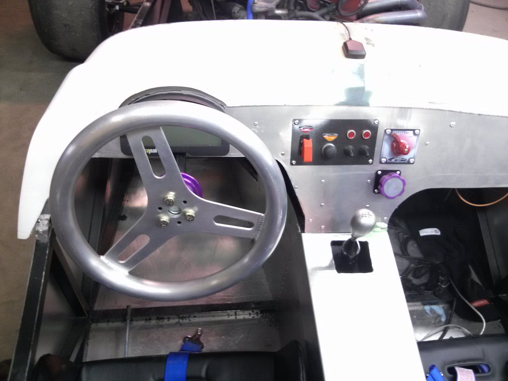

I also moved the GPS sensor outside of the fiberglass scuttle and bam, satellites. Pretty cool to see the data and - the software is definately a little cludgy to use but I suspect with time it'll make sense.
this is one of the many tuning runs - by default it starts logging at 25mph and shuts off 30 seconds after it's below 25 again.

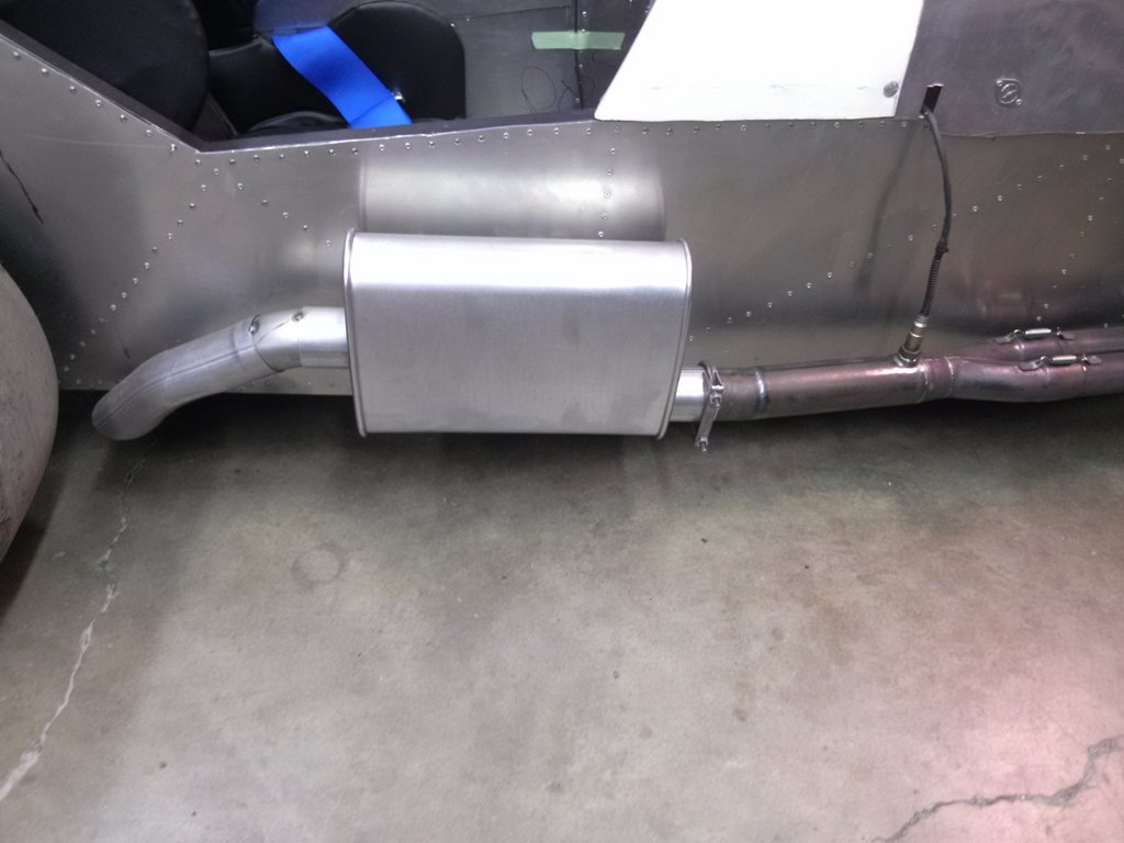

I've been fiddling with muffler options trying to get the ~120+DB down below 99DBs. I talked to a number of exhaust companies and spin-tech had the best answers so I picked up one of their mufflers and an amazon DB meter.
The giant, substantially heavier muffler brought WOT down to ~102DB.
I'm going to try another shot with a turbo style muffler and then if that doesn't get it done then i'll start playing mix and match with two mufflers to maximize power & sound.

the turbo muffler (thrush something or other) with a bit of a turndown has WOT down to ~96.8DB. That should be good for the majority of venues I run at.
It's also subtantially lighter than the spintech piece. Oh, and it cost something like 45 bucks... shipped... meanwhile, I don't want to compare that to the other two mufflers.

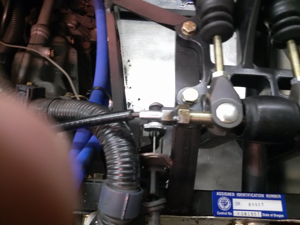

A buddy is going to co-drive next weekend and we had to trim a bit of the dash out so he could fit. I also fittted the brake bias adjuster
for anyone that plans on using the speedway bias adjuster - tilton changed their bias bar to a 7/16 size up from the 3/16 semi-recently. Speedway and wilwood still use the 3/16 bar. I made use of a nut and the welder to temporarily remedy the issue. Pegasus has the proper cable end available if you need to convert

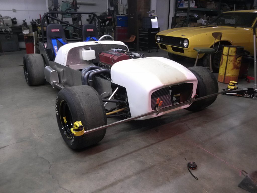

I corner leveled (not balanced, yet) with ballast for the driver and gave it my first pass at a semi-legit alignment. it's certainly more accurate than my as-assembled alignment which was wasn't half bad for camber but trash for everything else.
I picked up a few laser levels from clearance at home depot in place of strings. After using them I think the string might have worked better... Both are tedious and take getting used to

Strings are good for alignment. You can mark the tubes to align to the chassis and notch the tubes to hold the string. Then you have a permanent reference to work from. Maybe that's overkill, I never got that fancy. Once you get an enclosed trailer you probably start carrying a lot of crap around. I always stuck with a little open trailer like you have.

Certainly works in IndyCar, NASCAR, many ALMS teams, etc. Sting (bonus points if you use a fishing reel), rods, plumb bobs and steel ruler.

Tong, a good friend built this toe bar system…

That is a really slick set up. You could easily do something similar on a 7 and stringing would be a breeze.
It's pretty close to what is used in IndyCar and NASCAR. IN fact, probably a bit nicer. I'll try to get some pics someday.

That is a really sweet set-up. Things like this make me smile.
-Despite my ignorance, which I will now reveal with this question (never having aligned a car in my life): I assume that the front and rear posts on a given side need to be the same distance from the vehicle centerline. If so, how is this accurately achieved?
