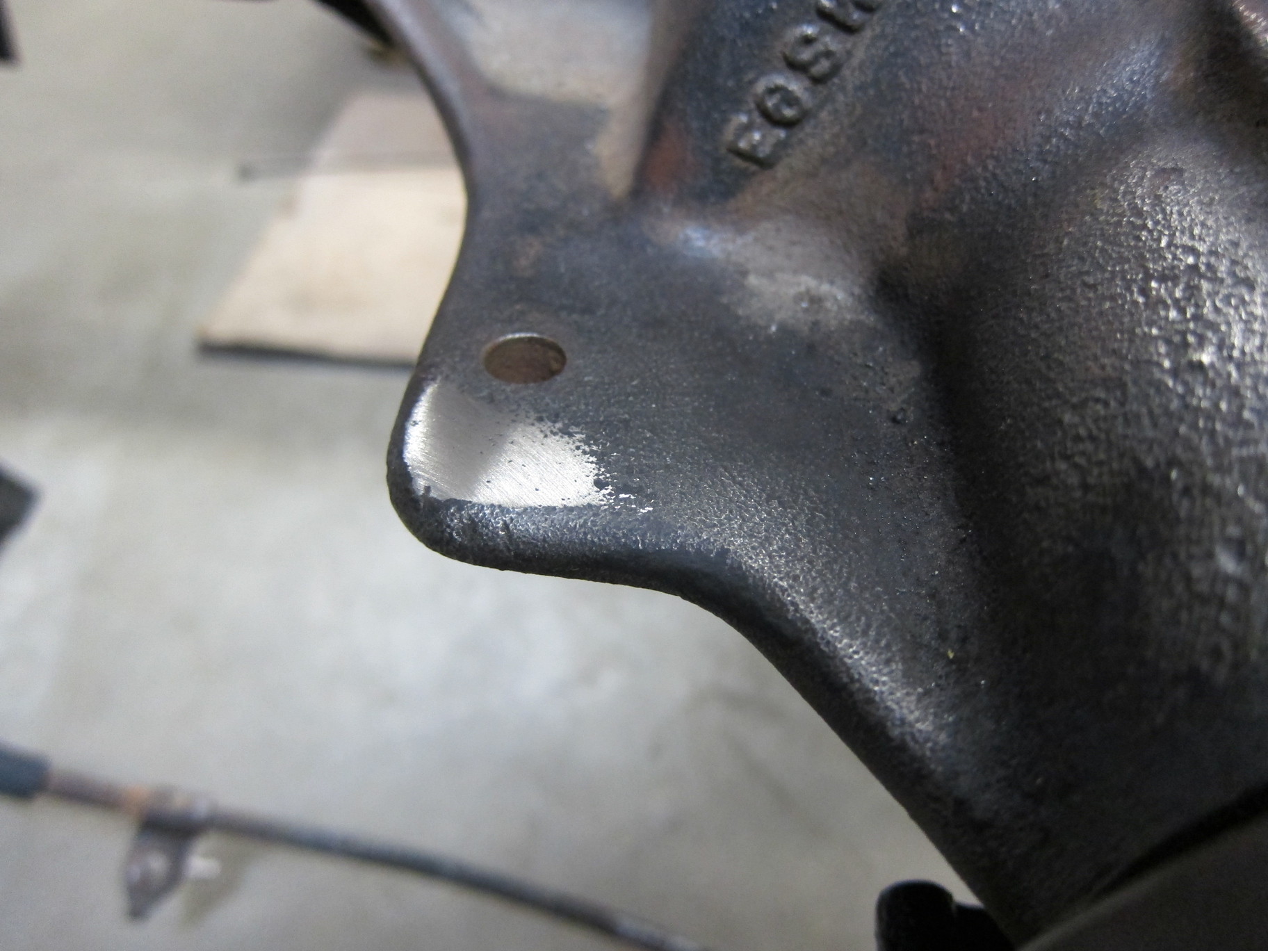

February 2013: lots of drivetrain parts. Notched the passenger side engine mount where it was interfering with the block. The engine mounts that came with the engine were broken (I bet the engine had a fun ~150k miles before I bought it) Transmission is a World Class T-5 5 speed (1st 2.95; 2nd 1.94; 3rd 1.34; 4th 1.00; 5th 0.63). Fox bellhousing
Image Image Image Image Image Image Image Image Image Image Image Image Image Image Image Image Image Image Image Image

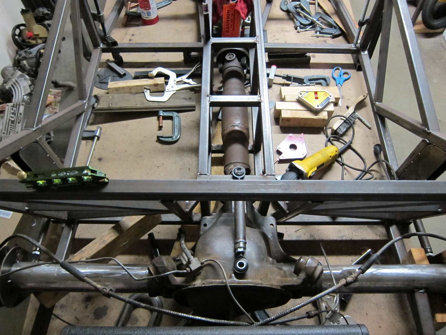

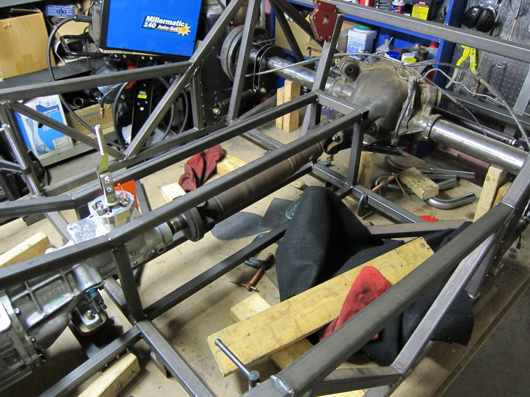

June 2013: summertime, temp/chopped driveshaft installed, continued center tunnel. IIRC,engine and transmission are offset 5/8" to the passenger side to compensate for pinion offset
Image Image Image

Started center tunnel diagonals. I want to make sure the driveshaft will never be able to reach the occupants.
Image Image

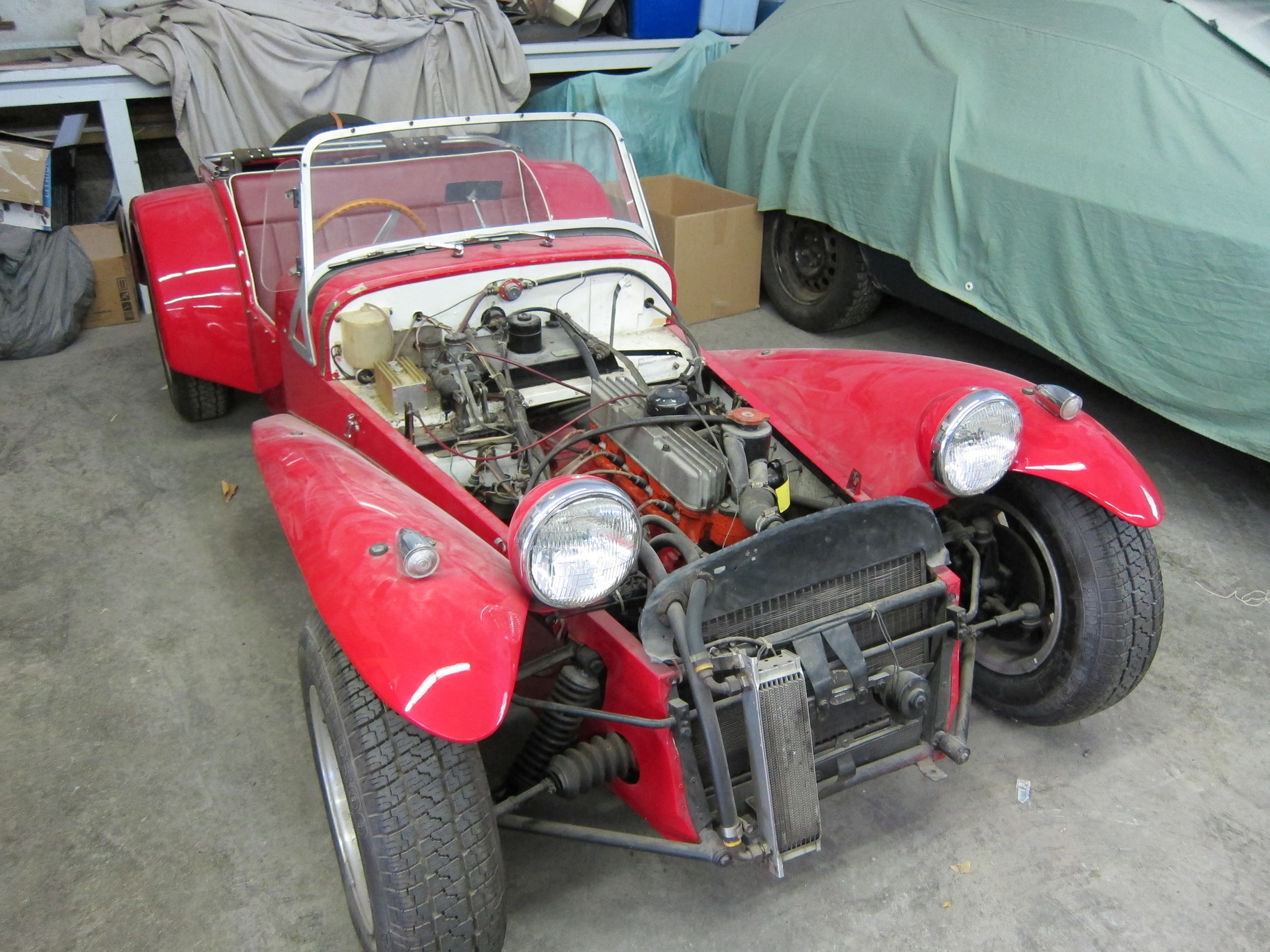

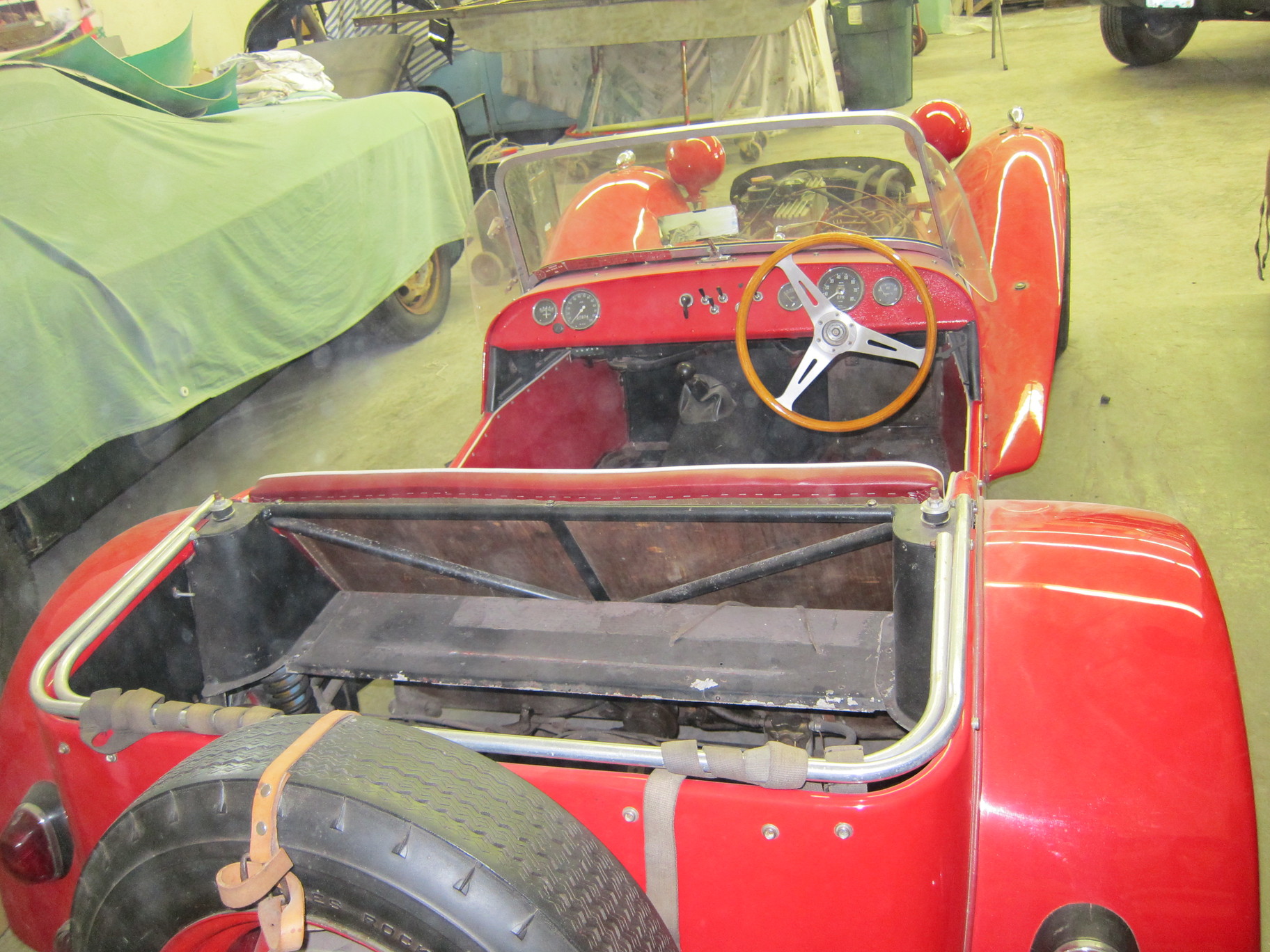

Saw this Lotus 7 when wifey and I drove up to talk to guy about welding a bracket onto the differential housing. He had a Lotus 7 in for some work. Pictures never give the same impression as seeing the car in person. In person, the car looked like a 'normal' car, just built on a smaller scale. The overall shape looks balanced, and I like the look of the clamshell fenders more seeing them in person.
The car didn't seem too much smaller than how I imagine a finished locost to be. We each had a chance to sit in the car, and it felt very normal to me: snug but not at all cramped. The seat was comfortable, probably OK for longer drives, reminded me of the seats in a MG Midget.

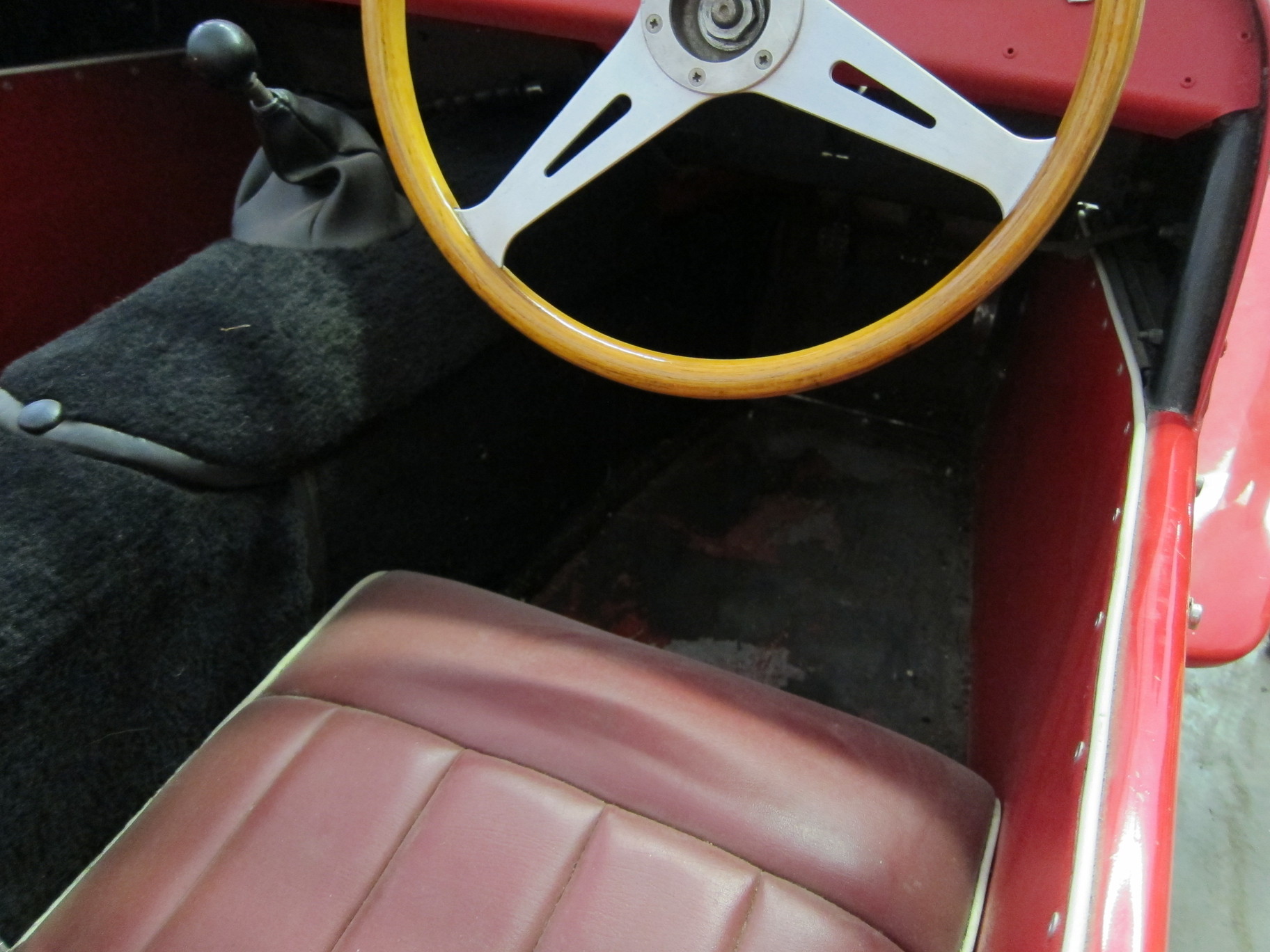

Ones legs stick out almost straight to the pedals, and the steering wheel felt close (and large). I believe I would like this driving position more than the one in my MR2 Spyder (which is pretty much the opposite). I test drove an Elise years ago, and it had a similar driving position as the Lotus 7: sitting 'in' the car rather than 'on' it. Hard to explain
The dashboard isn't vinyl over metal as I had guessed from pictures, but rather some kind of textured paint. I'd like a leather-over-metal dashboard on my build. I'd also like to copy the classic gauges and toggle switches

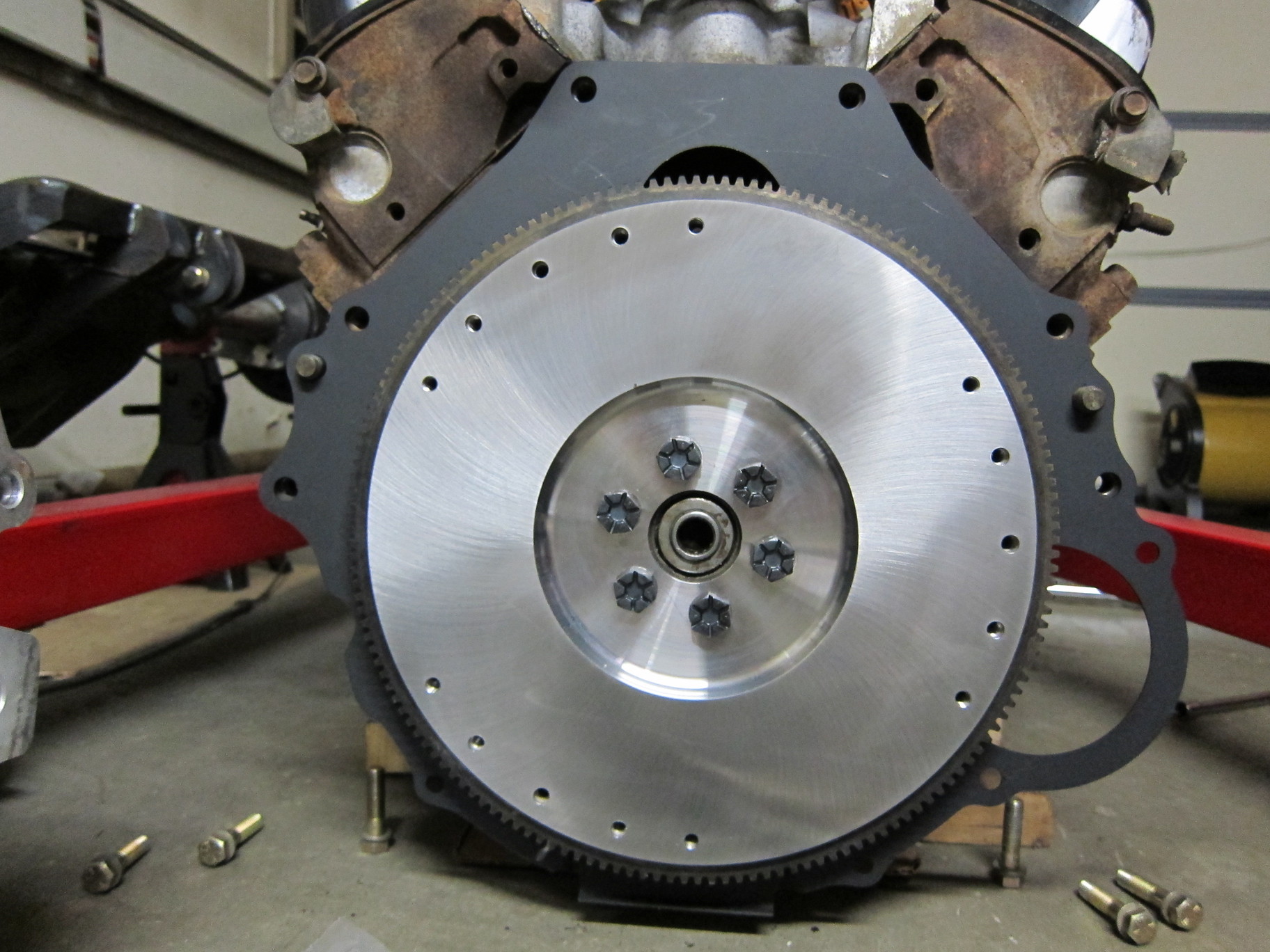

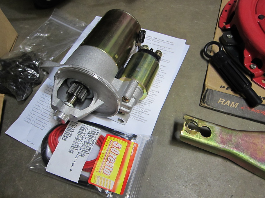

Easy and fun stuff: flywheel, starter, clutch. I got the lightest-duty clutch I could find. Flywheel is billet steel for better driveability.
Painted the block plate, as it was already starting to rust. Installed flywheel and clutch. Still not sure if I'll use a hydraulic clutch slave or a cable

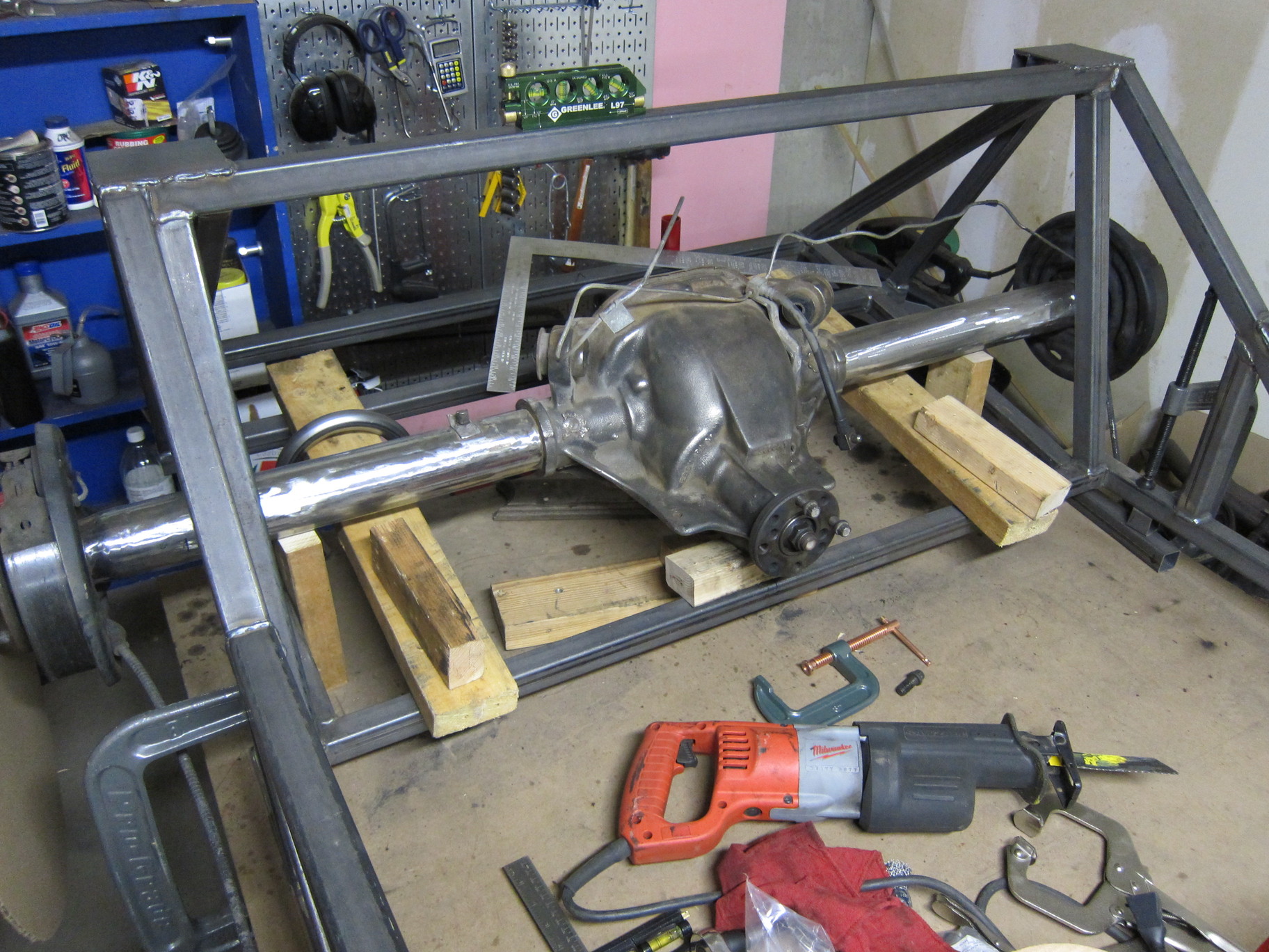

I may have put the engine bay diagonal tubes too close to the engine. There are several inches on either side, and I'm hoping that's enough to allow the engine to shift normally under load. Any thoughts?

Looks to me like you have plenty of clearance. More than my car, and I don't have any interference issues. Not with the engine, at least.

Before you weld everything up on the rear axle consider this;
All 3 of your links are way too short, this is an issue with Locost frames. I suggest you re-engineer your brackets to go towards the rear of the car as far as you can to get some length into them to stop the rollsteer they suffer.
Secondly, get your top link over to the right as far as it will go within the tailshaft opening - assymetrical power delivery requires assymetrical linking.
Lastly, with the top link over to the right you will want a little anti-squat to make it worth the effort, the front of the top link needs to be lower than the rear (or vice versa) either side of 1", it would be nice to have adjustment holes that you can test with. Run you panhard rod from the right side of the axle as low as practical angling up to the left side of the frame (driver's side USA) for the same reason. I strongly advise a panhard bar choice to help balance the torque you will have.
Here is Rod's 5.0 fine linkage attempt that is practical within the bounds of a standard chassis and what you should be aiming for at a minimum ...
4 links don't bind if set up properly.
