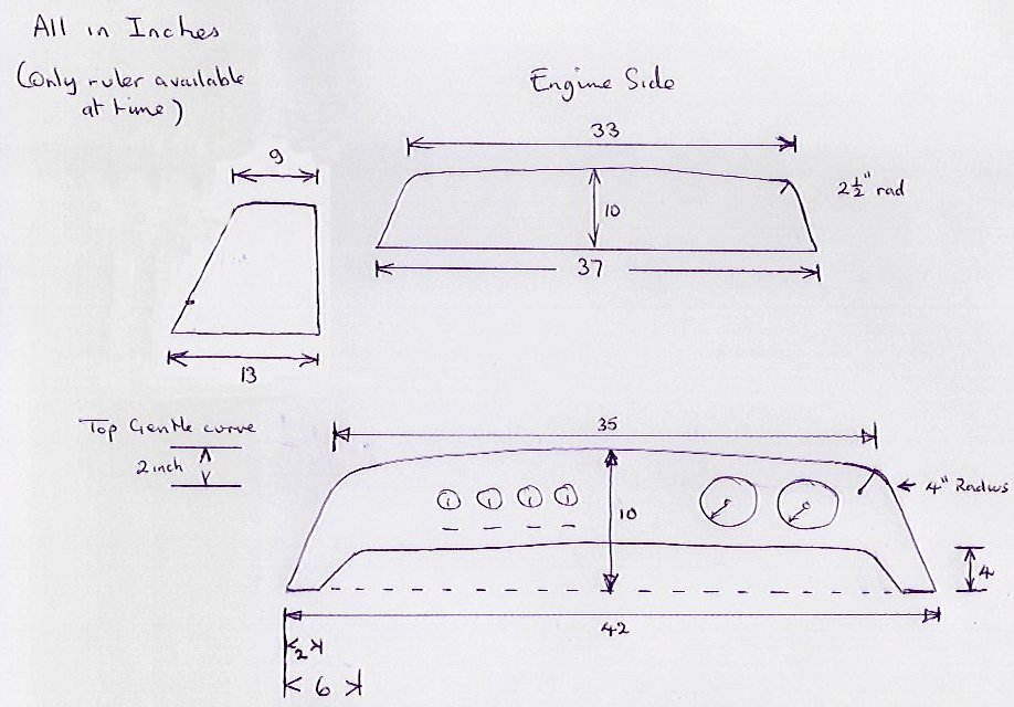

I thought about mocking it up and trying just what you suggested but I don't know what the profile is on the Coveland nosecone. (the skuttle is pretty well documented in the book) I'll just go ahead and get one since I will have to do so eventually.
George Crushing has the basic measurements for the nose cone and the Skuttle is avaliable in picture form. (links below)
http://www.georgecushing.net/Nosecone2.html
http://www.georgecushing.net/nosecone.html
AND
http://www.locost7.info/files/body/scuttle.jpg
(big picture, I didnt want to crowd your build log)
between those to your can mock up some front and back metal hoops to get a feeling of about how and were the the bulge would be.
I'll keep an eye out for you!
