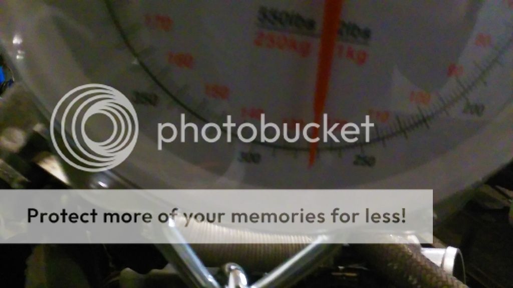

I know the pics are kinda crappy, but this is the 1.8t VW engine complete with manifolds,turbo, and alternator (no clutch).

Re: Summary of engine weights
That's lighter than I've been led to believe it would be
carguy123 wrote:That's lighter than I've been led to believe it would be
This engine has a very nice cast iron block and it is very compact lengthwise (just the right amount of bore spacing). When they design these blocks they do it for the long haul and use them worldwide. There are now also a couple of options for RWD transmissions.
