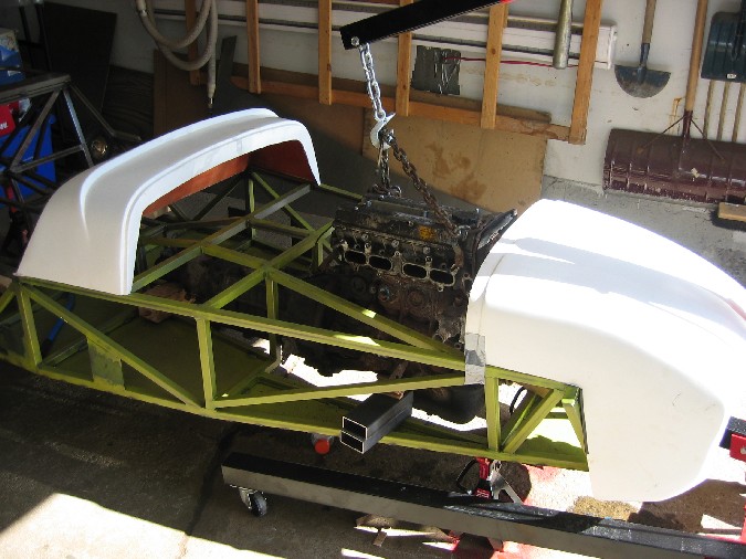

Hi everyone, Decided to put my project on the Log, It's only fair since, I've pick up a lot of ideas on the net, so might as well share what I've done so far.
This car will be a Track only car sharing duty between Solo 2 and Time trials. The Chassis is a book size incorporating some of the Ausie Mods.
Power will be by a built Toyota 4 AGE mated to a T50 trans. Suspension wise; inboard shocks upfront with Mustang 2 spindles and Speedway aluminium Hubs. In the back I'm putting a Toyota GTS solid diff with a mumford linkage. Wheel size will be 13*8 in the front and 13*10 in the back.
The fiberglass: Nose and scuttle are from Kinetics and the 11 inch rear wings are from Curtiss unlimited.
I have to admit that it's always fun to start from this
and get to this
The famous Ausie mods :wink:
and a drive shaft loop as required by the rules...
Right now, I'm taking care of the engine mounts...

Josh hit it right on the spot: The SCCA Solo 2 rules dictate a drive shaft loop for cars equiped with Racing Slicks. The frame is 16 gauge 1*1, the transmission tunel is 16 gauge 3/4*3/4. The easy solution would have been to put a section in 1*1 tubing, but I would rather have the 1/4 by 2 inch plate as the loop. Now the funny thing is, that part of the trans tunnel will all be panel off with 18 gauge steel sheets; in order to create a backbone, I'm therefore currious how they will check for it at tech. I'll make sure to bring my build book.
I'm not sure if I'll have an additional R tube, but I will have something there. I will also reinforce the bottom of the engine bay with a removable Y tubing section. Just got to get those engine mounts finished before tackling that.

Got back to the Locost a few weekend ago... Man I got to learn to say NO to my budies asking for some favours :roll:
Ok so After a few trials I set my chassis height at 2.5 inches up front and 3 inches at the rear.
I had to modify my original suspension bracket to fit my Low ride height :lol:
I also pick up this dry sump from ebay,
Should be fun adapting it to the 20 Valve that I pick up a few weeks ago...

Jawfish wrote:Ok so After a few trials I set my chassis height at 2.5 inches up front and 3 inches at the rear.
Height of the frame above pavement or roll center height?
I know Montreal... You need more than 2.5" of ride height! ;)

Post by chetcpo »
Mine is low, but not that low. My oilpan will have about 2 1/2" of clearance from the pavement. The only difficulty I see is locating the steering rack so high will require some head scratching. I look forward to seeing how you do it. :)

Jeff: Thanks… I’ve pick quite a few ideas from your site. Its one thing to know what you want in a race car, but it’s another thing to actually build it. It’s nice to see how others have solved some of the mysteries of car building for us first timer scratch builders. Yup got to spend time on my site to explain the “what’s” and “whys”.
Darth V8: Ride height. The only pavement this beast is going to see in Montreal is the PMG test center for some Solo 2 events. Imagine a surface of 17 football fields, flat as a pool table, and as much grip as Heartland Park :roll: (don't know if the last one is a good thing) you can actually see one of our course on this pic. http://maps.google.ca/maps?ie=UTF8&oe=U ... 5&t=k&om=1
Chetcpo: The funny thing is that I’m mocking with engine on the table right now…0 ride heights… :lol: With the dry sump I should have 2.25 inch of clearance. In my case it’s the bell housing that’s the lowest at 1.75 inches. Head scratching as been part of this build from day one. I agree that the steering rack will be fun. Right now the head scratching is centered on the drive train alignment. Because my engine is so low in the chassis, the diff sits really high, which will result on a crazy slope for the driveshaft. Right now I’m thinking of having a negative angle, which would kick up the tranny and give something decent.
It’s been a fun project so far. D-mod is quite interesting once you realize that your car will never see any public road unless it’s on a trailer. There plenty of room to think outside the box and try a few things. If it doesn’t work No Problem… You got a grinder and a welder to fix it :twisted:
Fred
